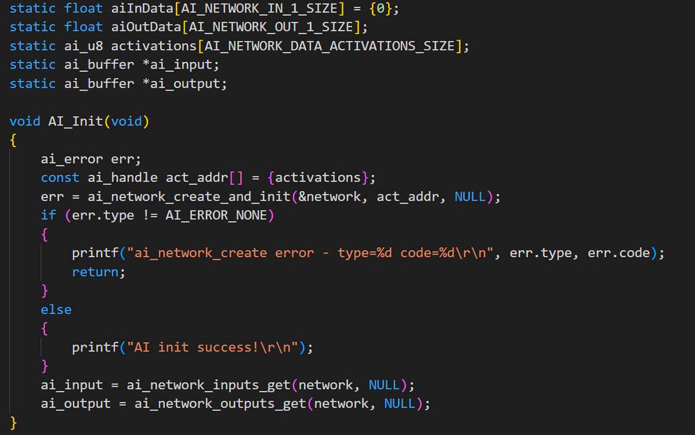

stm32h750 x-cube-ai , ai_network_create_and_init() code stuck
wink
Associate II
1 ACCEPTED SOLUTION
Accepted Solutions
I have already enabled the CRC IP by adding "__HAL_RCC_CRC_CLK_ENABLE();" before "AI_Init();" but still have the log "ai_network_create error - type=51 code=65"
The following is a part of my main.c file

static void AI_Init(void)
  ai_error err;
  /* Create a local array with the addresses of the activations buffers */
  const ai_handle act_addr[] = { activations };
  /* Create an instance of the model */
  err = ai_network_create_and_init(&network, act_addr, NULL);
  if (err.type != AI_ERROR_NONE) {
    printf("ai_network_create error - type=%d code=%d\r\n", err.type, err.code);
    Error_Handler();
  ai_input = ai_network_inputs_get(network, NULL);
  ai_output = ai_network_outputs_get(network, NULL);
  ai_error err;
    Error_Handler();

Best Regards
wink
Associate II
I have identified the issue, which is that printf forgot to redirect and the PLL settings generated automatically by cubemx are incorrect. These two errors were mixed together and caused
