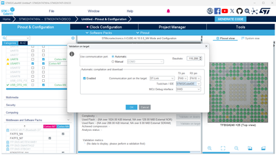

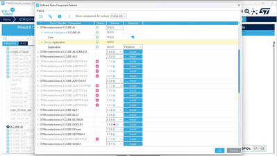

Hello @knight,
To do a validation target with X Cube AI:
Then, to create your own application, use the application template instead of the validation template

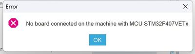

Thanks for the guideline! I followed your steps, successfully generated code in STM32CubeMX, built and run project in STM32CubeIDE, but when I tried to validate on target again, there is a "No board connected on the machine with MCU" issue. Do you know how to fix it? Thanks a lot again.

Dear Knight,
In order to perform validation on target you need connection to MCU UART via ST-Link Virtual COM Port (VCP) to exchange validation data with PC e.g. on NUCLEO board such a connection is implemented. I'm not sure what kind of STM32F407 board you are using (proprietary one ?), please make sure you have such a connection and ST-Link is capable to provide VCP profile (>= ST-Link v2.1). As reference you can see NUCLEO-F429 -> USART3 pins PD8, PD9 are connected to on-board ST-Link VCP.
