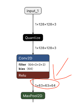

And I find out that stm32ai generates the wrong size for the scratch data of one Conv2D layer.
The correct shape should be (1, 63, 63, 64), but the generated scratch size is (1, 3, 63, 64).
