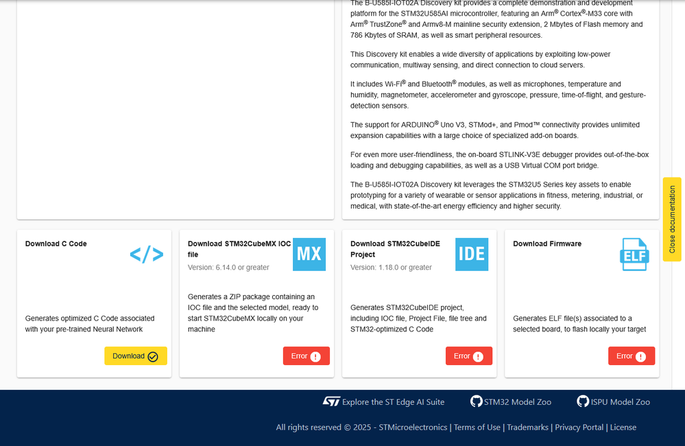

I have a tflite model that I want to test on my B-U585I-IOT02A Discovery kit, after some issues with X-Cube.AI expansion for CubeMX I decided to try use ST Edge AI Developer Cloud. Everything goes smoothly until I try to generate the code, All option to generate fail apart from the C code of the nn. As the error gives no explanation I have no clue of what happend and no way to fix it.

Hello @YuriM1,
I replicated it, we are working on a fix.
The issue is that the model triggers a timeout because of its size and the time it takes to finish the operation launched.
Have a good day,
Julian

2025-05-21 6:51 AM - edited 2025-06-03 6:31 AM
Hello @YuriM1,
Have a good day,
Julian
