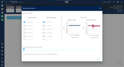

We encountered a problem while setting up our benchmark on NanoEdgeAI.
When we want to select the signals, we don't have a "Select All" button.
So we have to manually select all the boxes. The problem is that we have over 4,000 signals to select, which is tedious to do by hand.
So I'd like to know if there's a way to select everything so we can run the benchmark?
Thank you for your help!

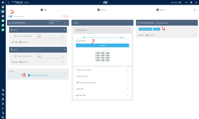

Hello @enzoguillard ,
You have so many files! :)
I would suggest you use the data manipulation tool.
You can find it on the main page on the right or the little DM button below the Home button.
Then import all your nominal files, click concatenate and extract lines.
Select all the line and click run. Then save the new file containing all your nominal signals:
Do the same thing for your abnormal signals.
Then, go to your project or make a new one and import your 2 new files.
In the next version, the way you import files is a little bit different and by default it would have selected all your files.
Thank you for your remark. If you have any other question, feel free to ask.
