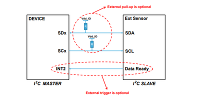

Could you please provide guidance on utilizing LSM6DSV as both a master and a slave in sensor hub mode simultaneously? Kindly refer to the attached image.

Ciao @FKara.3 ,
When sensor hub mode (mode 2) is enabled, both the primary I²C/MIPI I3C®/SPI (3- and 4-wire) slave interface and the I²C master interface for the connection of external sensors are available. These are the connections needed:
In AN5922 you can find a guidance from page 71.

AN5922 has a dedicated part for "Sensor hub mode example"

Ciao @FKara.3 ,
