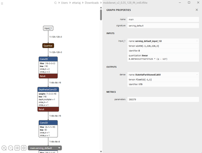

This model takes a float32 input [-1,1] and contains the scale and offset:

Hello @pmiracle,
You're right, I misread.
The float32[-1:1] is the output (look at the image).
The input is uint8[128,128,3] and most likely RGB values in the range of 0-255 as you pointed out.
Have a good day,
Julian
