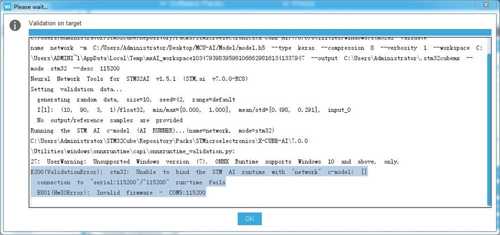

when I use the M4 core and validating an ONNX model on target (STM32F747I-DISCO), I got the following error:
E200(ValidationError): stm32: Unable to bind the STM AI runtime with "network" c-model: []
connection to "serial:115200"/"115200" run-time fails
E801(HwIOError): Invalid firmware - COM5:115200
0693W00000FD0LjQAL.jpgHere are some methods I tried:

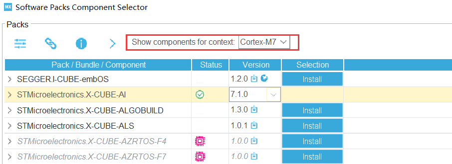

I tried on H747I-DISCO followed his instruction. If you are using a board with double cores, you can try to switch to Cortex-M7 only for X-CUBE-AI.
0693W00000NrgJrQAJ.pngBut it doesn't help to fix the same problem on my H735-DK board.
