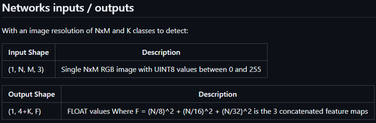

Now for the output of a YOLO Model, the information in the GitHub documentation must be followed:
For a model with a 256x256x3 input layer, the output format can be specified by calculating F.
In this case, N = M = 256.
(256/8)^2 + (256/16)^2 + (N/32)^2
1024 + 256 + 64
Which equals 1344, making F = 1344.
This information means that the output shape of the model will be (1, 5, 1344), you can confirm that your calculations are correct by checking the LL_ATON_DEFAULT_OUT_1_SIZE_BYTES define in network.h, for instance:
1024 + 256 + 64
