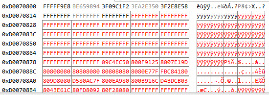

I'm trying to create an AI Vision application based on the STM32H747I_DISCO_FoodReco_Quantized application. I've made a custom board with the STM32H743ZI microcontroller. I believe the problem is that the data is not correctly written to the external SDRAM.
The line data from the camera that is written to 0x30000000 through DMA seems alright, and from my understanding, the data in 0x30000000 is used to build up a frame in the capturebuffer in the external SDRAM through MDMA. This capturebuffer is then transferred to a framebuffer in the SDRAM and the framebuffer is then used to perform the inference on.
There is data written to the framebuffer in my screenshot below, but it has a lot of F's seperating the data. I have no clue why this is happening. Is this a MDMA configuration error? Or a SDRAM configuration error? Possibly both?
What I did is I connected my custom board to an external SDRAM, that is different from the SDRAM used on the STM32H747I-DISCO board. The difference here is that I use a x8 wide SDRAM and the discovery board has a 32x wide SDRAM.
I modified the code in 'system_stm32h7xx.c' in the attached snippet to match the GPIO connections and changed MemoryDataWidth, ColumnBitsNumber, InternalBankNumber and RowBitsNumber to the correct values matching the SDRAM I use (IS42S83200G-7TL).

#endif /* DATA_IN_ExtSDRAM */I haven't changed the MDMA settings that were already present in the 'fp_vision_camera.c' file. When I change that the program runs into a dma error.
