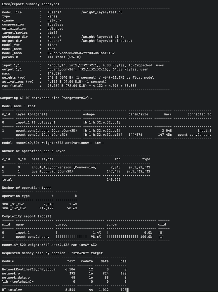

As a follow up to this, I've noticed that if I set "padding_values" to 0, and analyze the model, it's getting converted to a float32 conv anyway, so there's no optimised kernel (as far as I can tell) getting used at the end of the day anyway!
I used the above python script to generate the 1-layer 1-bit conv op, and then I see the following graph:
And I also get the following report:

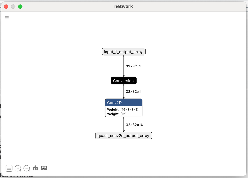

In this report we see the majority of ops being smul_f32_f32, which I interpret as this getting converted to a float32 convolution. I've read the documentation here which mentions this fallback to float32, but it doesn't indicate there is any way for us to know what the eggregious parameters are that are causing the fallback (would be great to have some more helpful error messages here in the framework).
Is there any warning/error/reason for this to fall back on the float32 conv? Does anyone know anywhere in the docs that instruct exactly what is, and what isn't, supported (in terms of combinations of parameters) to get this working?
Has anyone got a working example of larq/1-bit convs working on github/some place that they can kindly point me to?

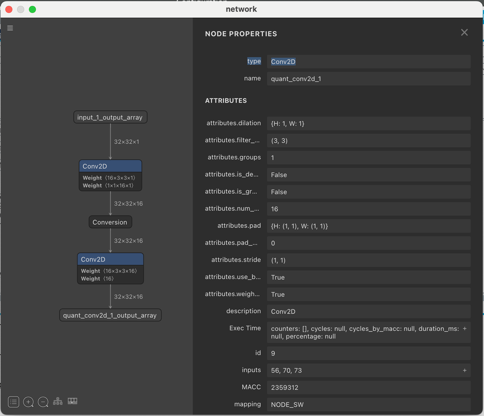

I wondered if perhaps because it's the first layer (and only) layer, it might be silently failing on that, this is briefly mentioned (not as a hard requirement) in the docs:
It is preferable to leave the first layer and the last layer in higher precision: 's8' or 'f32'
So I made a 2-layer 1-bit conv2d model. Initially the graph did look suspect, because it just has Conv2D types of ops, compared to what I expected to see from the docs:
But I do see some sxor_s1_s1 ops in the analysis report, so this may well be working fine!

c_id m_id name (type) #op type
0 1 quant_conv2d (Conv2D) 147,456 sxor_s1_s1
1 1 quant_conv2d_0_conversion (Conversion) 32,768 smul_s1_f32
2 2 quant_conv2d_1 (Conv2D) 2,359,312 smul_f32_f32
total 2,539,536
Number of operation types
operation type # %
sxor_s1_s1 147,456 5.8%
smul_s1_f32 32,768 1.3%
smul_f32_f32 2,359,312 92.9%
Complexity report (model)
m_id name c_macc c_rom c_id
1 quant_conv2d_conv || 7.1% || 6.5% [0, 1]
2 quant_conv2d_1_conv |||||||||||||||| 92.9% |||||||||||||||| 93.5% [2]
macc=2,539,536 weights=9,920 act=70,400 ram_io=0However, with a more complicated example (based on a larger model, tricky to share here concisely), I'm finding all of my 1-bit convs used in a very similar way to the above simple examples are falling back to conv2d/failing with errors.
I'm not sure if there are clearly defined lists/tables of what works, what doesn't, or if there are any ST-led workshops/calls where I might be able to discuss this with an engineer etc, because I presume stedgeai is falling back to float32 conv2d because a parameter isn't set in a supported way that is not visible to me!
