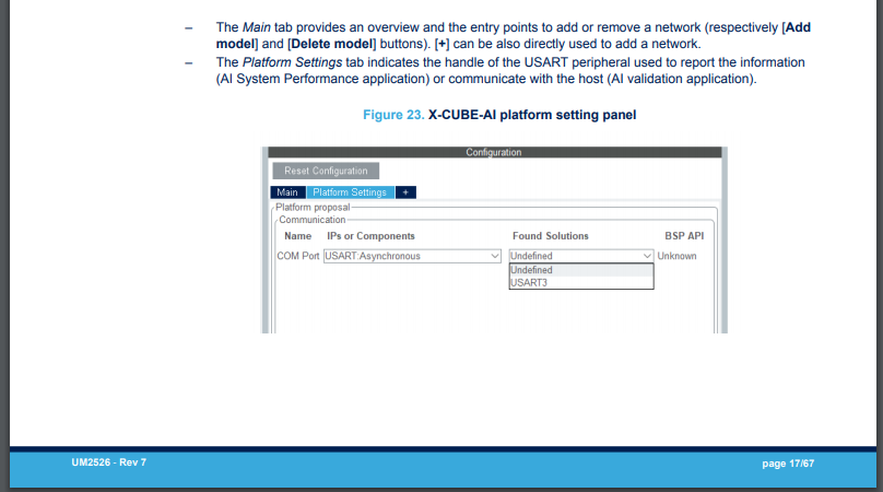

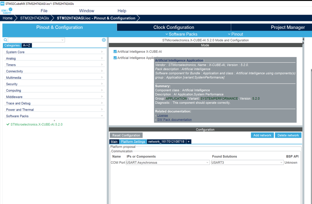

This is how it is supposed to be:

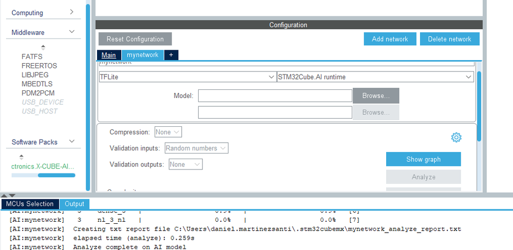

This is what I have:

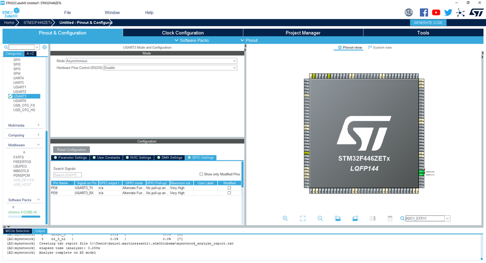

As you can see, the USART3 is correctly configured:

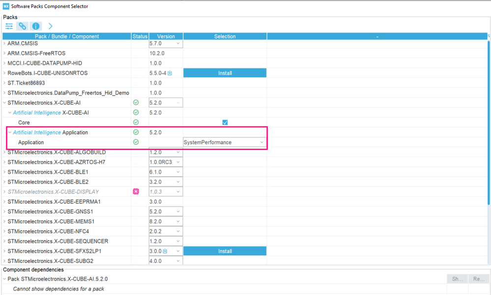

To select the USART3 on the "Platform Settings" configuration tab of X-CUBE-AI, you need to select SystemPerformance for Application component in Software Packs Component Selector .
For more details please refer to SW Pack documentation available from STM32CubeMX TAB configuration.

Hi, @DMart.13 ,
Sorry for the delay.

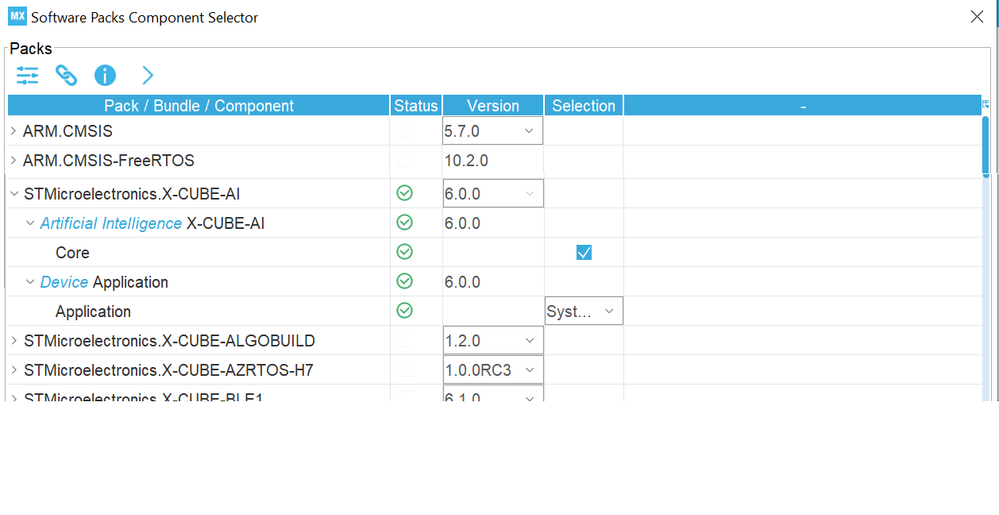

Hello Houda,
I'm using X-cube-ai 6.0.0, I cannot see Artificial Intelligence Application, only core, (see the screenshot below). Your version is 5.2.0, I don't know if that matters. Please advise how I can resolve this issue.

Hello Houda,
After several trial and error, (remove everything, install AI 5.2.2, and then 6.0.0), finally it is working as expected.
