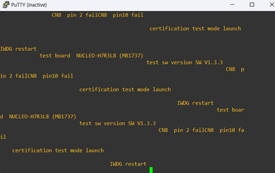

I am using the NUCLEO-H7S3L8 board, with CubeAI 9.0.0 through ST Edge AI Developer Cloud, using the STM32CubeMX .ioc file, the building has no errors, but when I press the RESET button on the board, I get the following message through the COM port.

I have also tried to do it with STM32CubeIDE manually, but I get the same error through the COM port. How can I correct it, am I not using the right card, and if so how do I get to identify a suitable card?

To get your PuTTY display to do line breaks properly, see:
https://the.earth.li/~sgtatham/putty/0.83/htmldoc/Chapter4.html#config-crlf
