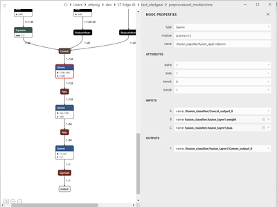

It seems there is also an issue with the Gemm layers in your model.
If we take a look at the first one:
With:
  • A is (1, 144)
  • B is (128, 144)
  • C is (128) (broadcasted)
  • Y is (1, 128)
And:
  • transA=0 → A is not transposed (remains 1x144).
  • transB=1 → B is transposed before multiplication (B changes from 128x144 to 144x128).
  • alpha=1 → No scaling on the A * B^T product.
  • beta=1 → The bias (C) is added as is.
So, your operation effectively becomes: 𝑌=(𝐴×𝐵𝑇)+𝐶
You can try to replace the Gemm layers by with basic layers such as transpose, matmul and add.
Something like this:
import torch
# Define the inputs
A = torch.randn(1, 144)    # Shape (1, 144)
B = torch.randn(128, 144)  # Shape (128, 144)
C = torch.randn(128)       # Shape (128,)
# Perform equivalent Gemm operation using matmul, transpose, and add
Y = torch.matmul(A, B.T) + C  # B.T gives shape (144, 128), matmul gives (1, 128)
# Print result shape to verify
print(Y.shape)  # Should be (1, 128)
Please double check with the Gemm pytorch documentation that this is correct.
Have a good day,
Julian

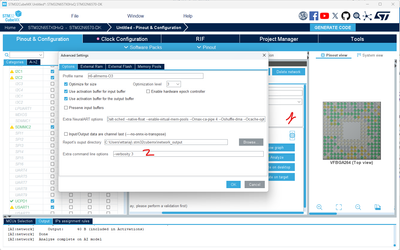

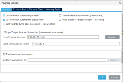

Hello @Nephalem ,
Yes indeed, it is hard to tell.
In the X Cube AI menu, you can click setting and set --verbosity 3:
But I don't think it is enough.
What you should do is use stedgeai.exe manually.
When you do a validate in X Cube AI, it literally does:
stedgeai.exe generate --model your_model --target stm32n6 --st-neural-art
So you can open a bash terminal and do this manually but you also need to first do:
export _DEBUG=2
to have more logs.
Have a good day,
Julian
