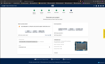

I have recently bought a STM32N6570-DK and I am trying to follow this tutorial to try and implement an example model on my board. I am able to get results and good benchmark but when I go to Generate Your Project I am unable to download anything. It doesn't show any option to download the files.
I believe it have been should be something shown like this in the video
Kindly help me in this regard.

Hello @athern27,
Indeed, because of the Export Control Classification Number (ECCN) imposed by the US, we don't have the right to deliver code for the N6 without a form.
For the moment we disabled the download on st edge ai cloud while waiting for a status concerning the ECCN.

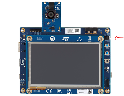

Also, make sure to connect your N6 using a usb C to usb C cable on the stlink port.
Try to put both button to the left and flash and then to the right (I don't remember which side it should be).
When changing the side, you need to unplug and plug again the N6
