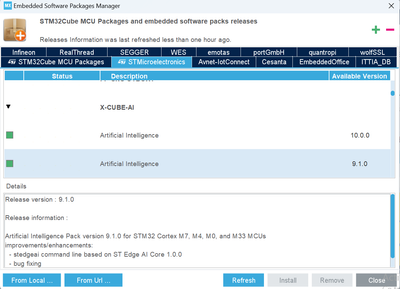

2025-05-21 12:41 AM - edited 2025-05-21 12:56 AM
Hi @Julian E. ,
Thanks For your update. I tried to install the new verision of Xcube Ai from Cube MX, but there it does not shows any version to be installed, I also tried refreshing the page the version you described is not available to install. I have shared a picture of the same.

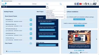

2025-05-21 4:47 AM
Hello @VinaySankar,
You probably have to update CubeMX:
Click Help > Check for Update
Or you can install the update using a .zip.
Click Install package as you did, then from local and select the zip from the X Cube AI 10.1.0 that you can download here:
https://www.st.com/en/embedded-software/x-cube-ai.html
Have a good day,
Julian

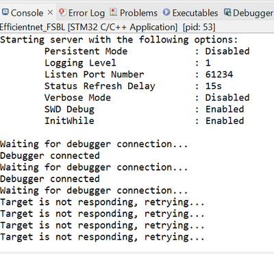

2025-05-23 12:53 AM - edited 2025-05-23 4:24 AM
Hi @Julian E. ,
I have successfully created a project file with cube MX and used an model from the ST modelzoo Model link :https://github.com/STMicroelectronics/stm32ai-modelzoo/blob/main/image_classification/efficientnet/ST_pretrainedmodel_public_dataset/food-101/st_efficientnet_lc_v1_128_tfs/st_efficientnet_lc_v1_128_tfs_int8.tflite
While running it to the board an error message with
this is what hapening while running the code and it suddenly moves out of the debuging mode can u please help me with the solution for this one also.
Also for information while I am creating project with example selector i created a sample project of LED blinking. While running this project there were no issue while running this code.
Thanks
