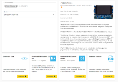

You can generate a code example that use the model with a random input and send via serial some metrics (inference time, predicted class etc) on a STM32H747I Disco using the ST Dev Cloud:
You need to import a model .onnx, h5 or .tflite then go through the steps. You can basically skip everything until you reach the last part.
You can download different things depending on what you want.
Currently the CubeMX will have an issue because the cubeAI version in the dev cloud is higher than the one you can download in CubeMX (version 10.0 that came out today, it is maybe already fixed).
I don't know if it works for other board, you can test it, with this H7 I tested it, so it works.

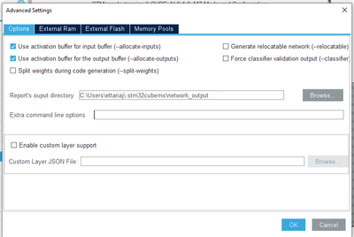

  • The Embedded Inference Client API is the "old API" that cubeMX uses
  • The Embedded Inference Client ST Edge AI API is the "new API" that you can use if you want using the Extra command line options in the Advanced options
So, as you said, you don't use the function with the stai from the new API.
I wasn't aware of this eitheir, but now I know thanks to you :).
As for what to add in the Extra command Line options, I will need to look for it.
