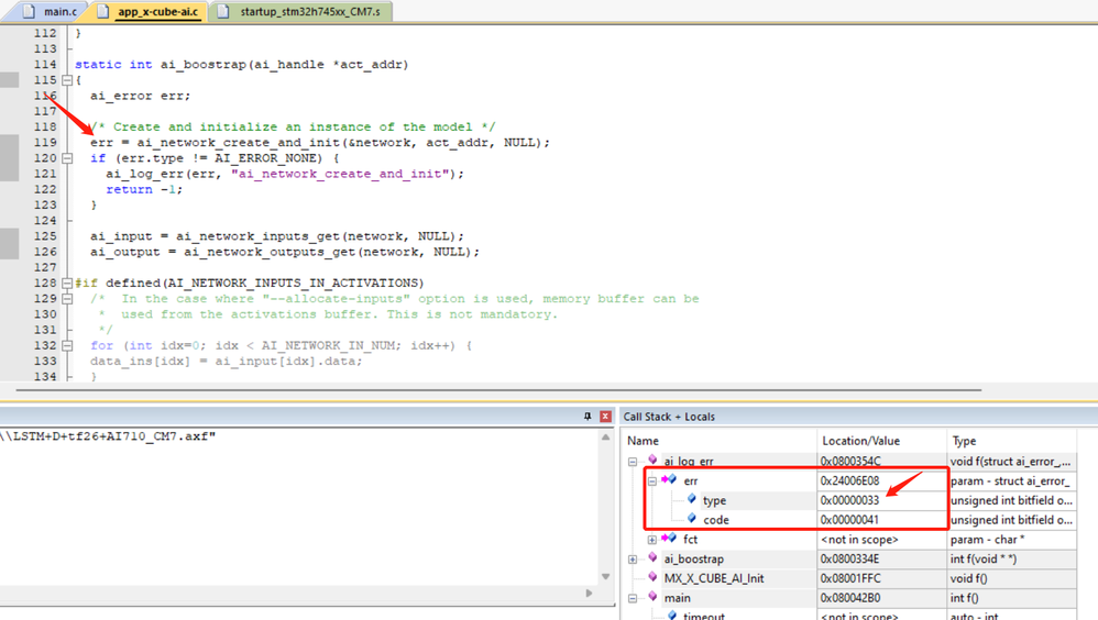

I built the LSTM network with keras 2.6.0 and generated the MDK project with CubeAI 7.10. However, in running the program AIInit() reported an error with an error type of 33.Do you know what the problem is? Thank you very much!

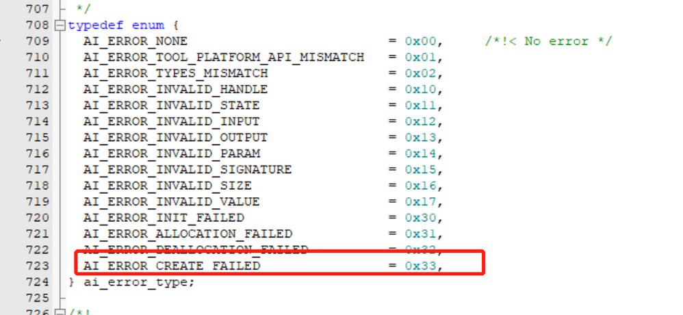

I looked at the meaning of the error type. This is (AI_ERROR_CREATE_FAILED), but there is no documentation telling me how to solve this problem. I wouldn't have this problem with CubeAI 6.0.If you know where to help documentation or workarounds, please let me know. Thank you very much!

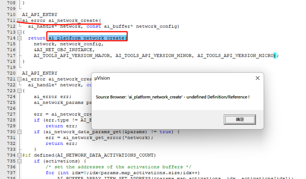

I've been using GO TO define refe's method to locate the error. But when it comes to this API, it appears undefine.
2022-07-22 2:28 AM
Try stepping into it, then.

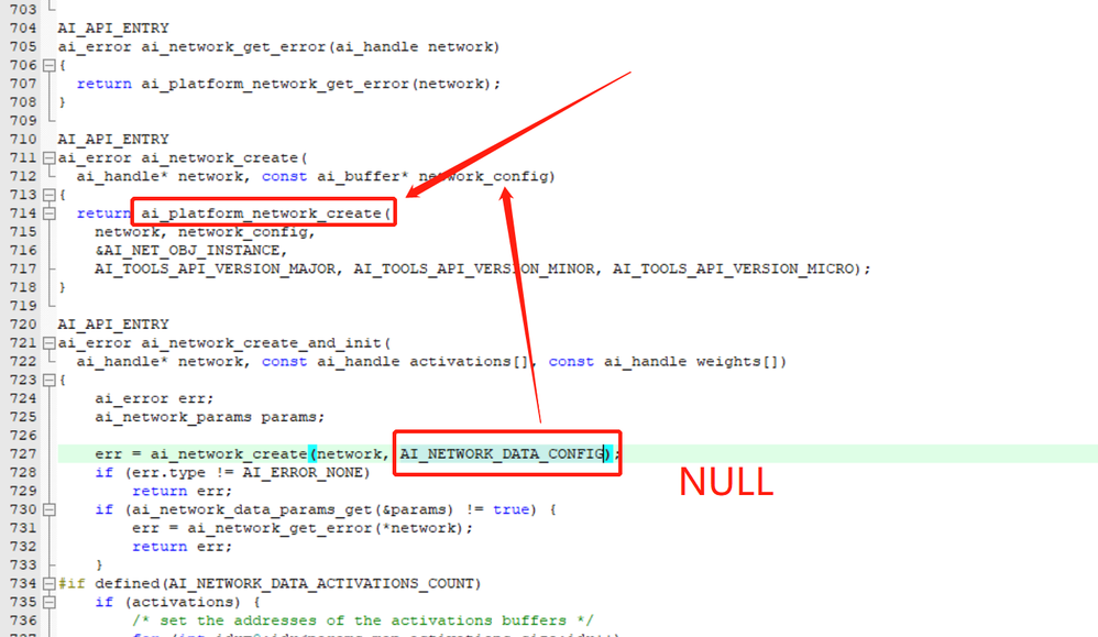

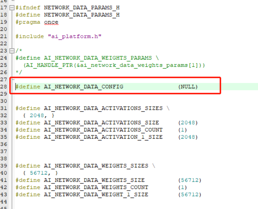

I can't get into this function. But I found that the value of the (AI_NETWORK_DATA_CONFIG) parameter generated by CubeAI7.1 is NULL. This is also the input parameter of this function. Could it be a problem here. Do you have a reference document for reporting errors, thank you!

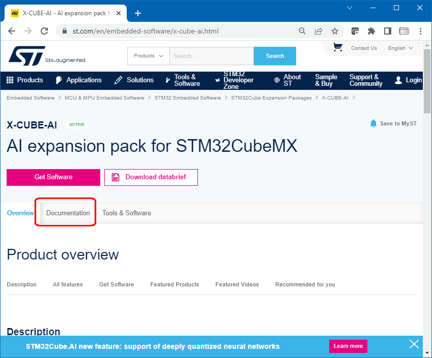

"Do you have a reference document"
Here?
