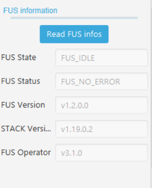

Thanks for the update! Since I'm done working with the datalogger, I've tried flashing the PDWBMSOC fp back onto the board, both at 0x08007000 and 0x007000 via ST-LINK (the board does not appear on the sensor app after the BLE_Ota_RFWKPCLK_LSE was pushed to 0x08000000). I've updated the FUS alongside starting both it and the BLE stack, and have attached a picture of the FUS info below.
I've used stm32wb5x_BLE_Stack_full_fw.bin for the FUS at 0x080CE000, from the Coprocessor binaries in the proteus firmware package. BLE_Ota_RFWKPCLK_LSE is at 0x08000000.
I suspect a memory address is incorrect, but documentation provided in other FPs seems to indicate that we've both got the right addresses.

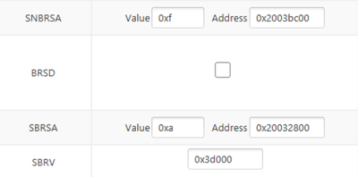

according to the SBRV OB, I also seem to be pushing my updates to the right locations.
To confirm that the board runs fine with the above Firmware at the current positions, I reuploaded the NEAI datalogger to it, and confirmed it works. I've also tried using another phone with the STBLE sensor app, and the stub doesn't show up in FOTA mode there either. I'm probably missing something incredibly obvious here.
