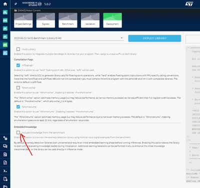

    1. You can get the "knowledge" from NanoEdge AI Studio, if you load this, you will get the exact same library that you got in the benchmark. To do so, you need to check the option to get the knowledge and re compile the library:
      In the .zip, you will get a new file to add to your embedded project. Finally, you can call the function:
      neai_anomalydetection_knowledge(knowledge)​
