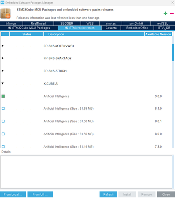

Where is the stedgeai command? I am using Windows and using "Embedded software Packages managers" to install the x-Cube-ai.
I don't see any issues or errors while installing it. I also tried to remove and install the latest version again, but I am having the same issue.

You should have the stedgeai.exe under
C:\Users\xxxxxx\STM32Cube\Repository\Packs\STMicroelectronics\X-CUBE-AI\9.0.0\Utilities\windows
if it is not the case I recommand to download X-Cube-AI from st.com and not from STM32CubeMX, in the downloaded zip you'll find the pack that you can install with STM32CubeMX (using the from local button in the update of the packages) and the zip that contains the command line.
STM32CubeMX will ask you for the zip but if it doesn't you can always unzip this zip under
