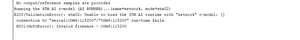

Thank you for your attention. At first I used "validation on target" with my STm32H747-DISCO with the example FP-AI-VISION1_V3.1.0 (because with that I can determine that the problem isn't from the code) and after that I wanted to do it with a F429I-DISCO and a code of my design. And "validate on target" didn't work for the F4 and the H7, I have the same problem as this guy, but the answer didn't fix the problem.

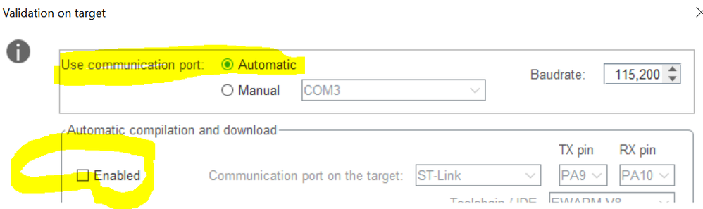

I will show you my method, I'm surely doing it wrong. First I select the card on the select board menu. Then :
Finally I resolve cloc issues, generate the code (without changing the minimum heap and stack size), build the CM7 project, plug my board via St-Link, run the code and "validate on target" (on COM-3 and 4). I have always the same error :

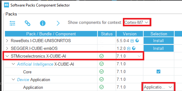

Hello Numa,

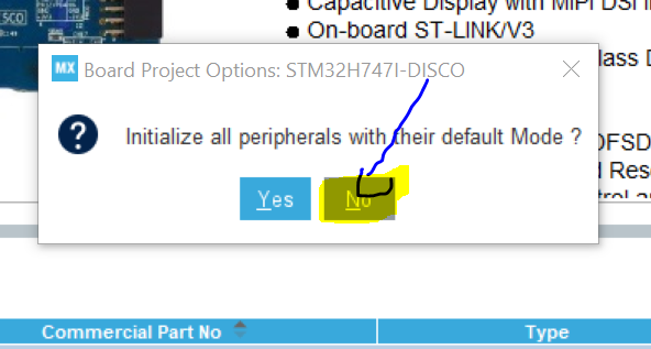

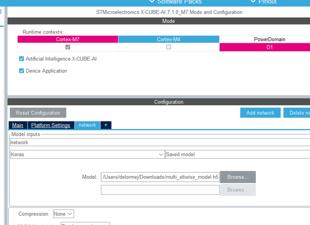

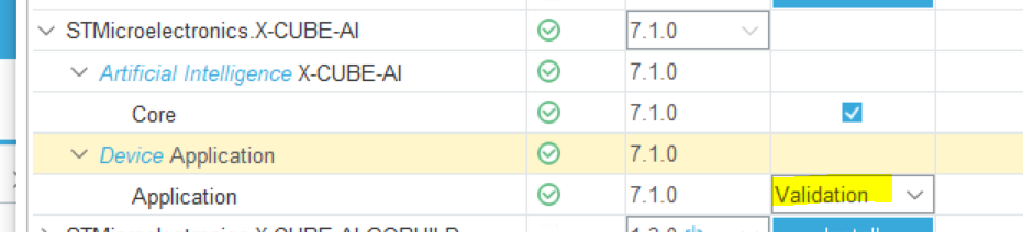

I don't see the real issue in your method. I have applied the following sequence w/o issue.

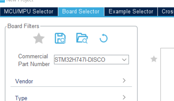

0 - I have created a new project from scratch with a basic model: CubeMX 6.4.0 + X-CUBE-AI 7.1 + STM32H747I-DISCO

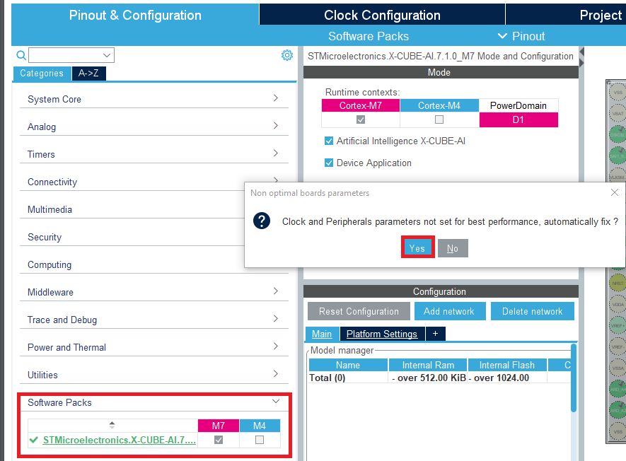

1 - It is preferable to not initialize all peripherals with the default mode.

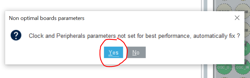

2 - Select the built-in validation application (Cortex-M7)
3 - Click "YES" to atomatically set the max MCU clock

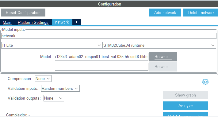

4 - Import a model

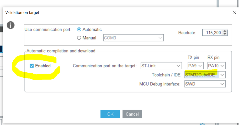

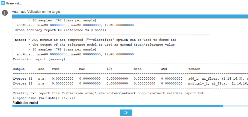

5 - Perform "automatic" validation on target. I have selected STM32CubeIDE here.
After a build and flash of the two firmwares (M7 & M4), we have:

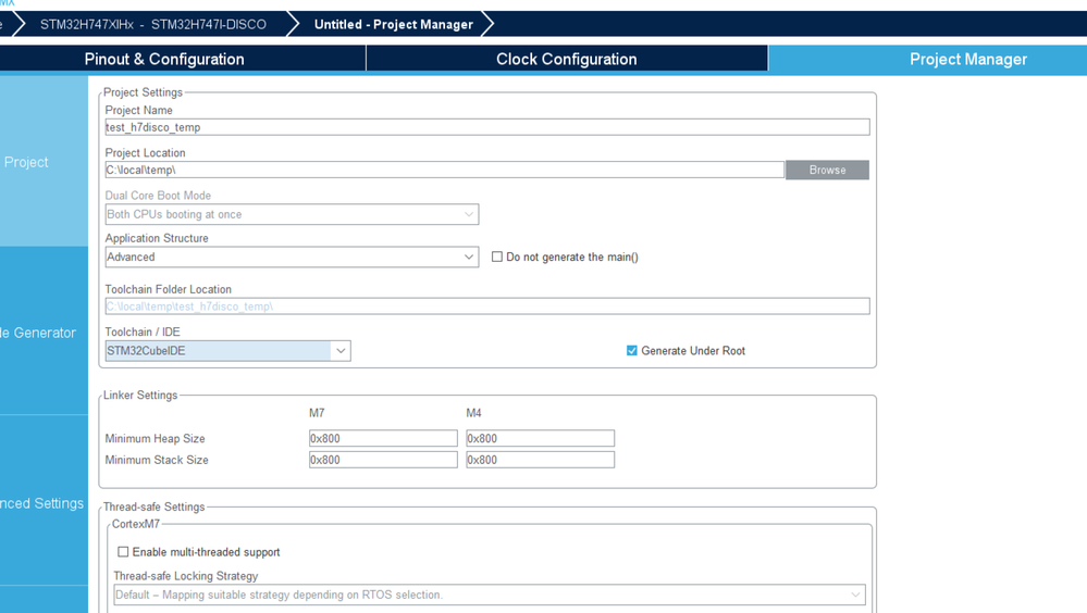

At this step, the board is normally flashed and can be directly used to perform a new validation on target w/o re-generation of the projects with for example the user-data.
STM32 IDE project can be also generated (for debug purpose or for example to increase the heap/stack) for your prefered STM32 IDE.
You open the project with your prefered STM32 IDE, build and flash the board.
After this step, you can perform a new validation through the UI, or to use the ai_runner interface to perform new scenario of validation.
