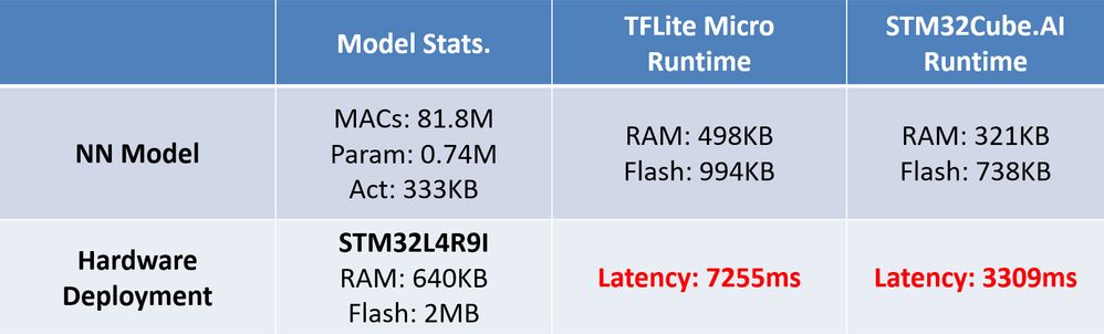

Hi Jean-Michel,
Thank you for your reply. The following is the comparison between TFLite Micro and Cube.AI runtime based on the same model:
From the results, Cub.AI is much faster than TFLite Micro.

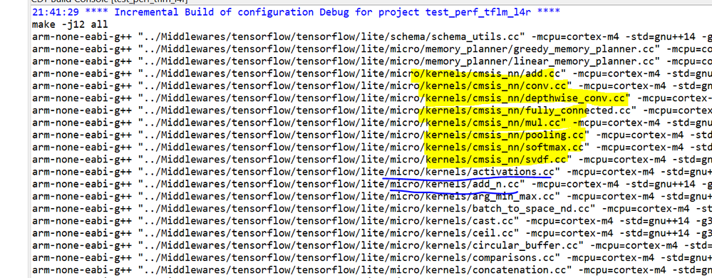

2021-08-18 1:41 PM
Hi Jeff,
Thanks to share with us the results of your experimentation. As mentioned previously, all TFL operators are not based on CMSIS-NN, following snapshot (based on the log of a STM32CudeIDE project) shows the kernels which are CMSIS-NN based (highlighted in yellow) else "default' implementation is used. The generated STM32 project is equivalent to use the TAGS=cmsis_nn (now OPTIMIZED_KERNEL_DIR=<optimized_kernel_dir> is used with v2.5). The exported source tree for the sub-folder "Middlewares/tensorflow " is equivalent to the output of the TFLM script (create_tflm_tree.py)

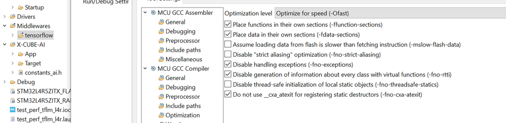

+ Last point for the compiler option
Have you tried the "Optimize for speed (-Ofast)" or "-O3" for the compilation of the TFLM files or for the whole project. Perhaps also w/o debug option.

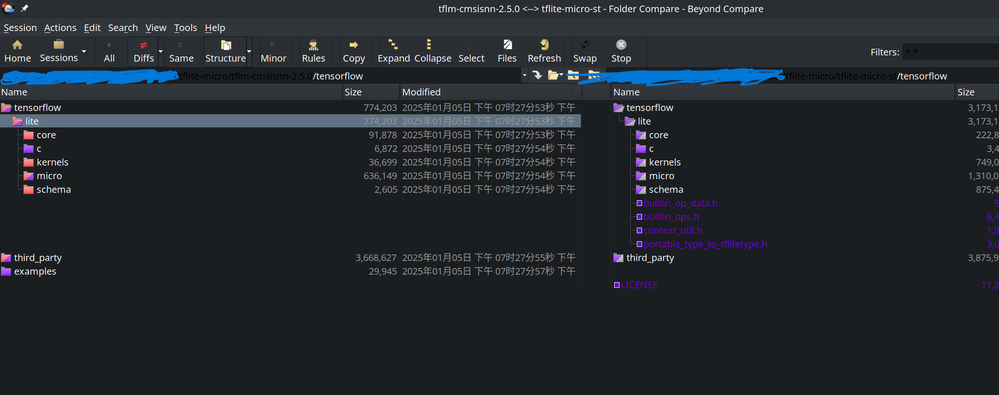

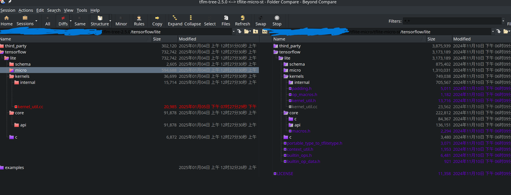

2025-01-05 4:48 PM - edited 2025-01-06 7:24 PM
Hi jean-michel.d,
I find this discussion is really useful for me. And recently, I'm tring to build a tflm tree projects without CMSIS_NN(Using default reference kernel). As your hint, I clone a local tensorflow 2.5 version and construct the projects with the following command:
python3 tensorflow/lite/micro/tools/project_generation/create_tflm_tree.py \
-e hello_world \
--makefile_options="TARGET=cortex_m_generic TARGET_ARCH=cortex-m7+fp" \
../tflm-tree-2.5.0
-e hello_world \
--makefile_options="TARGET=cortex_m_generic TARGET_ARCH=cortex-m7+fp OPTIMIZED_KERNEL_DIR=cmsis_nn" \
../tflm-cmsisnn-2.5.0
