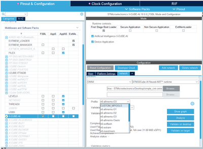

I am using the X-Cube-AI to deploy a neural network onto a STM32N6570-DK board. I selected the "n6-allmems-O3" option, and after analyzing, it shows two data, labeled as used RAM and used Flash. I am wondering since I have selected the "allmems" option, the RAM usage refers to the usage of the external RAM or the internal RAM, and the Flash usage refers to the internal Flash or the external Flash.

Yes, I think the best way is to edit user_neuralart.json and add a field for example:
"CUSTOM_MPOOLS": {
"memory_pool": "./my_mpools/MY_CUSTOM_MPOOL.mpool",
"memory_desc": "./my_mdescs/stm32n6.mdesc",
"options": "--optimization 3 --all-buffers-info --mvei --no-hw-sw-parallelism --cache-maintenance --Oalt-sched --native-float --enable-virtual-mem-pools --Omax-ca-pipe 4 --Oshuffle-dma --Ocache-opt --Os"
You can find the file here:
C:\Users\YOUR_USER\STM32Cube\Repository\Packs\STMicroelectronics\X-CUBE-AI\10.0.0\scripts\N6_scripts\
Then in Cube AI you can select it:
