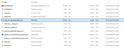

The network_data.hex comes from the network_atonbuf.xSPI2.raw
The .raw file is an intermediate format containing model data, and you need to use the ST Edge AI tools to compile it into a .hex file that's ready to flash onto your STM32 device.

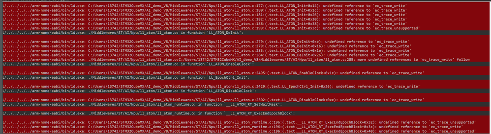

I have encountered problems when generating the application program now.

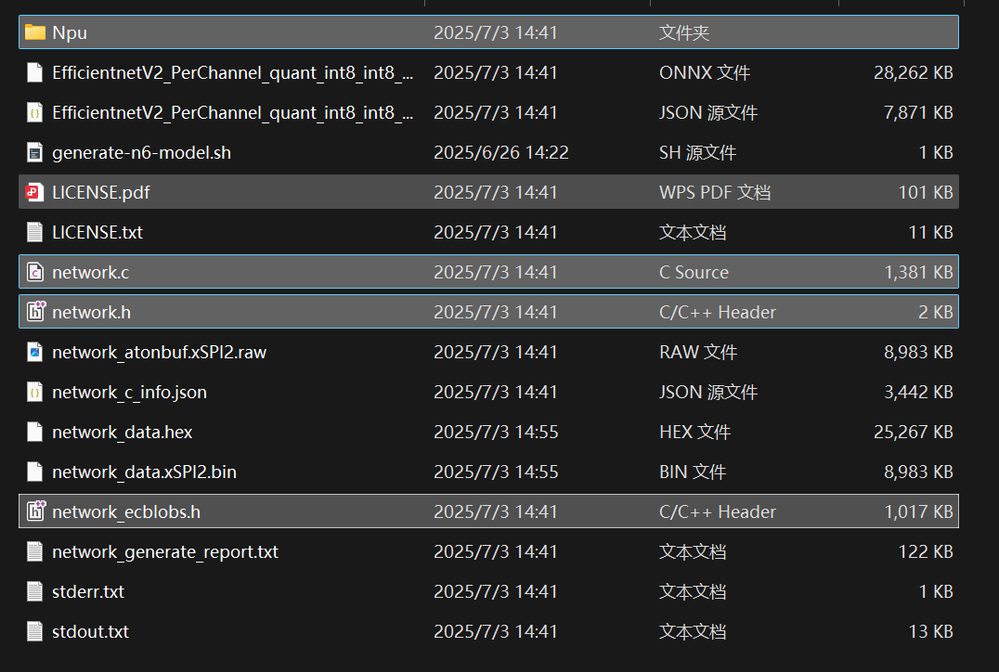

Previously, when I used the ST Edge AI program (invoked via the command line on the terminal) to generate model weight files (hex files) and files such as network.c and network_ecblobs.h for my model, it simultaneously generated the following files for me (see the pictures in the attachment).
Currently, I only copy network.c and network_ecblobs.h into my project, and then add some files to the Middlewares\ST\AI\Npu\ll_aton folder. Similar to ll_aton_reloc_network.c and ll_aton_reloc_network.h. This Project can be compiled normally. After adding the header to the bin file in the Appli\Debug folder and generating the project-trusted.bin file, network_data.hex and ai_fsbl.hex, and burning them into the stm32n6 development board, it can work normally. However, the effect was very poor. The recognition model I deployed could only identify a few items, and the probability of the neural network output was only around 10%.
I suspect that it might be because I didn't put all the files generated by the STedgeAI tool into the project that the model deployment effect was not good

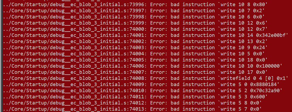

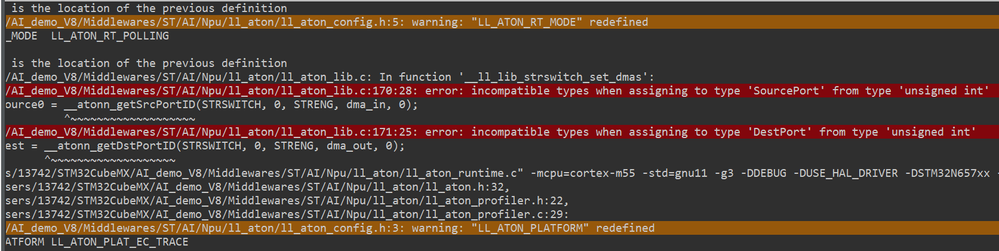

I tried to put all these files into my project, but it couldn't complete the compilation.The possible errors it might encounter are as follows:
