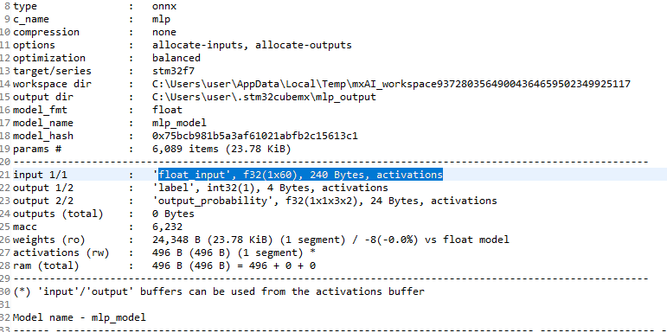

I'm working on deploying an MLP model on STM32F746 using X-CUBE-AI. The model was converted from ONNX format, and I’m running into trouble feeding the input features and retrieving the prediction result
I want to run inference with the following flow:
float input_data[60] = { /* preprocessed features */ };
float output_data[1]; // expecting softmax probabilities
int output_label; // expecting predicted class label

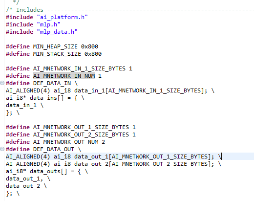

I'm unclear on how to actually use the interface generated by Cube.AI:
What are the correct steps to initialize and fill the ai_buffer structs?
Do I need to manually align my input/output arrays, or use the data_ins[] / data_outs[] generated by default?
What is the purpose of macros like AI_HANDLE_PTR(...) and AI_MNETWORK_IN?
I tried calling ai_mlp_run(...) like this:
but I get build errors or invalid pointer types
model information :
app_X-cube-ai.h:

Hello @Stone_chan,
When you create your project in CubeMX, select the last version of X Cube AI and the application Template.
Then in the generated code, you will find app_x-cube-ai.c in /X-Cube-AI-App.
The main functions here are the MX_X_CUBE_AI_Init and MX_X_CUBE_AI_Process.
In the MX_X_CUBE_AI_Process you will find 3 parts:
The way to pass data is through the function acquire_and_process_data(data_ins). By default, it looks like this:
int acquire_and_process_data(ai_i8* data[])
/* fill the inputs of the c-model
for (int idx=0; idx < AI_NETWORK_IN_NUM; idx++ )
data[idx] = ....
return 0;
The for loop here is used if you have multiple input to give your model. In most case you have one, so you will only pass 1 time and fill data[0].
Same for the post_process(data_outs) function.
The data that you have to pass are 1D array of size of your input/output and be careful, by default the data_ins and data_outs are in int8 (ai_i8). So if you are using float32 for example, make sure to adapt the code.
For your board in particular, the MX_X_CUBE_AI_Process is not called in the main.c.
You can add it in the while(1) in the main function:
