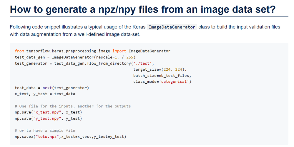

Should I pass a jpg image in "validation input" then click on "validate on target"?
2023-04-11 6:22 PM - edited 2023-11-20 9:09 AM
No, STM32 does not support image format input, you need to convert the image to NumPy (.npy Document) test set first.
