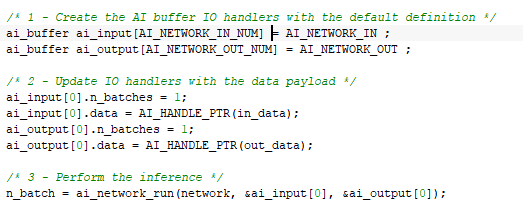

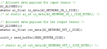

You can use the size provided in this file this way:
In this example I was feeding accelerometer inputs to the network like that:
And using outputs this way:
Best regards,
Romain

2021-06-10 6:32 AM
Sorry if I wasn't precise enough,
In the code above, in_data is the buffer I used to perform the network inference, I am just assigning values to the in_data buffer like a normal C array (using indices). Let's dig a little bit deeper into the process : In this code sample, you can see how to inject your data into the network and use the inference function "ai_network_run(...)".
Hope it's clearer ! :)
Romain

2021-08-11 9:25 AM
AI_NETWORK_AUDIO_AI_IN_1_SIZE indicates the total size of the input buffer in term of number of items/elements. AI_NETWORK_AUDIO_AI_IN_1_SIZE_BYTES indicates the associated size in bytes. I suppose in your case that the type of data for the input is float, this explains the 4 ( = sizeof(float)).
AI_NETWORK_AUDIO_AI_IN_1_SIZE_BYTES can be used to allocate or to define the input data buffer to store the input data.
If the buffer is allocated statically, you have two possibilities:
ai_float in_data[AI_NETWORK_AUDIO_AI_IN_1_SIZE]
// or
AI_ALIGNED(4) // to align the buffer on 4-byte boundary
ai_unit8 in_data[AI_NETWORK_AUDIO_AI_IN_1_SIZE_BYTES];Arrangement/layout of the data/items inside the buffer is dependent of the shape but it follows the standard C-definition for the arrays. See "C-memory layouts" section in the embedded documentation ("Embedded Inference Client API" article.
(typical location of the doc in the X-CUBE-AI pack: C:\Users\<user_name>\STM32Cube\Repository\Packs\STMicroelectronics\X-CUBE-AI\7.0.0\Documentation\index.html).
