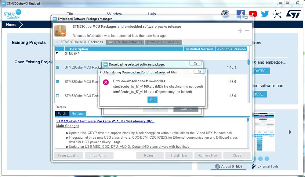

I am trying to use the STM AI by following the instructions in this document.
I get the above mentioned error while trying to download it from the CubeMX.
I tried downloading it from this website and it simple does not start downloading.
I tried downloading it from its Github repository and it gives a network error.
Could you please let me know how to resolve this issue?
Thank you.

2021-05-05 5:42 AM
This problem still exist, i changed proxy configuration and checked credentials more than one time..
These are the phases i see:
1) the download proceed correctly until the end (1239MBytes)
2) Unzip File: stm32cube_fw_v1160.zip
3) Connection to HTTP Server ...
4) ERROR downloading the following files:
stm32cube_fw_f7_v1161.zip (Timeout during download)
Since the first zip has been downloaded correctly i think is not proxy or my fault.

Something amiss here, current CubeMX just downloaded/installed, checked install of last two F7 packages
