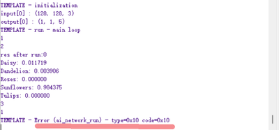

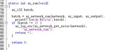

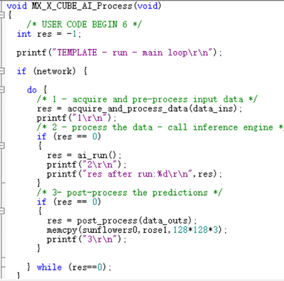

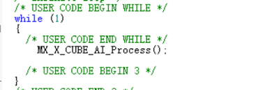

I meet that when follow func is in its second loop
And I find the value of var 'batch' is not 1 in the second loop,Why?
