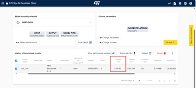

Hello @Julian E.
How do I evaluate the operational efficiency of the model on the development stm32mp25x board? Currently, the model trained with yolov11 has a very large inference speed after quantization. I would like to know how long each network layer of my model takes to infer, so that we can optimize the model structure better.
2025-09-23 2:55 AM

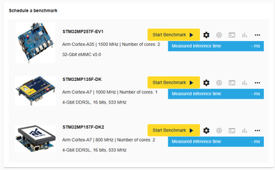

Hello @fanronghua0123456,
I think the ST Developer Cloud could help you: https://stedgeai-dc.st.com/session
You can import model, select the MP2 and benchmark its inference time on a real board in our board farm
You can also do it manually with the validate command: https://stedgeai-dc.st.com/assets/embedded-docs/stm32mpu_command_line_interface.html
