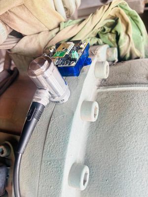

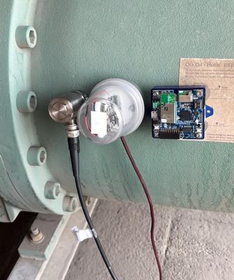

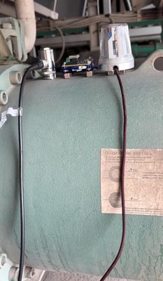

Now we have a Compressor/Chiller/Motor equipment in Industry on which we are measuring the Acc Rms and its velocity during its normal working condition.  Now as IIS3DWB sensor is digital sensor it's output is measured in all direction, but we are only taking into consideration the effective Y axis of digital sensor as it aligns with the SPM vibra meter. Now we took readings of Acc Peak, Acc Rms, Speed Rms using both STWIN kit and SPM vibra meter. But the measured reading from the STWIN are drastically different from the vibra meter (i.e almost double at higher vibrations). Also we converted the value of Acc rms into G, as the measured value of acceleration is in G for vibrameter and velocity rms have same unit of mm/s in both devices.
So i would like to know what could be the issue here as measured values are taken in similar conditions and both devices were well mounted ? Shouldn't STWIN TDM data should match or come nearby the readings of SPM vibra meter ? Or we are doing wrong thing by comparing the analog sensor output with digital sensor output although the end appplication is same.

Hello @DMORR.18, thanks for the direction information. As you can see in 1st (on top) and 2nd (on side) images, we are considering the Z axis measurement of STWin as Z-axis is perpendicular to the surface on horizontal and vertical plane.
Secondly we are currently using USB to transfer ACC and Velocity rms values to serial terminal for monitoring purpose. The image was captured when we were monitoring data using BLE application but in that scenario different sensor was used. So just consider image as refference of our setup.
After some advice from other PDM forums, i have reduced the bandwidth of IIS3DWB by applying a LPF i.e ODR/20 (600Hz) and ODR/45 (1300Hz) to make the device bandwidth in range of that of Vibrameter whose range is from 2-1000Hz bandwidth. Also enabled the software high pass filter in the firmware. And by making this change, we can see most of our ACC rms values are macthing with that of Vibrameter acceleration data but still we are able to see  70-80% deviation in calculated velocity rms.
So we would like to have more clarity regarding what other configuration we can change to bring the velocity values closer.
