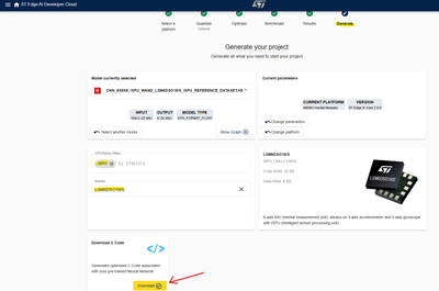

Hi @mariagragna ,
You can use the developer cloud. At the last step of “Generate,” you need to click on “Download,” after selecting ISPU as the “CPU” and LSM6DSO16IS as the “board,” as per the screenshot below:
Then you get a zipper with three folders (inc, src, lib), which must then copy into the template's “ispu” folder.
As a template, we suggest you use the specific template for ST Edge AI.
