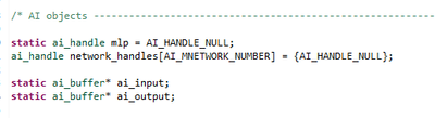

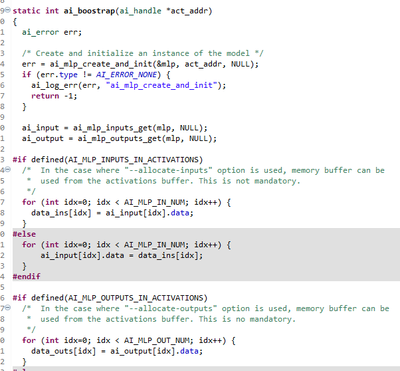

Regarding ai_mnetwork (multi-model manager) and accessing the models’ native I/O descriptors:
My understanding: I can use ai_mnetwork_get_private_handle() to obtain each sub-model’s private handle, then call ai_<model>_inputs_get() / ai_<model>_outputs_get() to retrieve the native ai_buffer arrays, avoiding manual shape/format filling.
Is this the officially recommended workflow? Or is it better practice to use the report structure and manually fill shapes and formats?

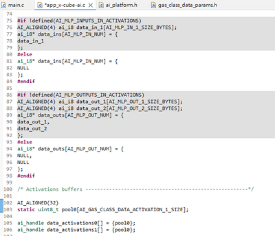

- During the execution of a given model, in particular when the inputs/outputs buffers are allocated in the activations buffer, they can be overwritten during the inferences (overlay feature to optimize the RAM usage). They are used in place and can be used to store intermediate results. In the case where no inputs/outputs allocation option is used, input buffers are not re-used but the application has no way to know when the buffer is no more read.
Concerning the question 2:
- If the deployed models are executed sequentially (guarantee by the application), the activations buffer can be shared safely (activation buffer is considered as a scratch buffer). Weights (const data) are specific for each deployed models. For the input/output buffers, this approach can be the same.

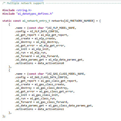

Regarding ai_mnetwork (multi-model manager), this module is not really designed/supported for this purpose. This module is only used for aiSystemPerf/aiValidation test-application to support multiple models (sequential only mode).
Jean-Michel
2025-08-27 7:55 PM

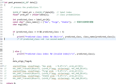

Hi, jean-michel.d
Now I in ApplicationTemp mode , code can generate ai_network_entry_t related structures and APIs , and there are no problems with execution
this module is not really designed/supported for this purpose => So how do you recommend running model A before running model B?
