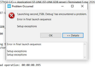

here's my project
as u can see i configured the debugging session to start from the fsbl as following
following the tutorial on how to debug stmn6 boards .
However , im getting this error
and its persistant even when i try to flash the app and the model beforhand using stm cube programmer and only download the fsbl .
im using stm cube ide 2.1.1
stm cube programmer 2.22.0
stm cube ai studio 1.1.0
