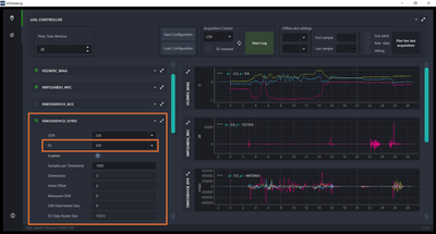

HSDPython_SDK contains a GUI-based demo called hsdatalog_GUI.py. Have you ever used it?
Sensor parameters can be setup from the menu available on the left of the GUI.
Is this widget not working properly on your side? Which Python version are you using?
