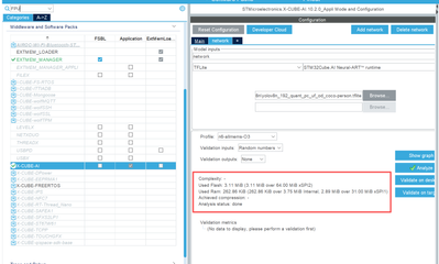

Dear ST staff, Recently, while using STM32CubeMX with CubeAI to deploy the yolov8n_192_quant_pc_uf_od_coco-person.tflite model from object_detection onto the STM32N6570-DK development board.
        Subsequently, following CubeAI's configuration, I programmed the network_atonbuf.xSPI2.bin file into the 0x71000000 memory location

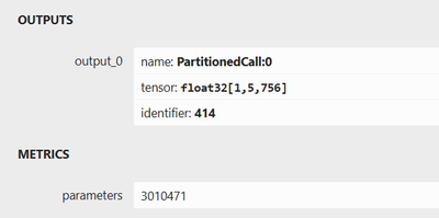

    I have attempted numerous methods to parse YOLOv8n data, but frequently encounter anomalous values, particularly when seeking configuration details within the [1x5x756] structure, where many values are disproportionately large.

First of all, the model is quantized in int8, it is just that the input and output are float32 (converted to or from).

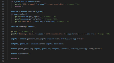

To do so, open checker.py
  • Comment the line 62 and replace it to load your dataset:
    inputs = np.load(“./dataset.npy)
  • Save ‘outputs’ after the line 64 with something like: np.save("./ output.npy", outputs)
  • Comment line 66
Run again the checker.py and you should get the output saved.
