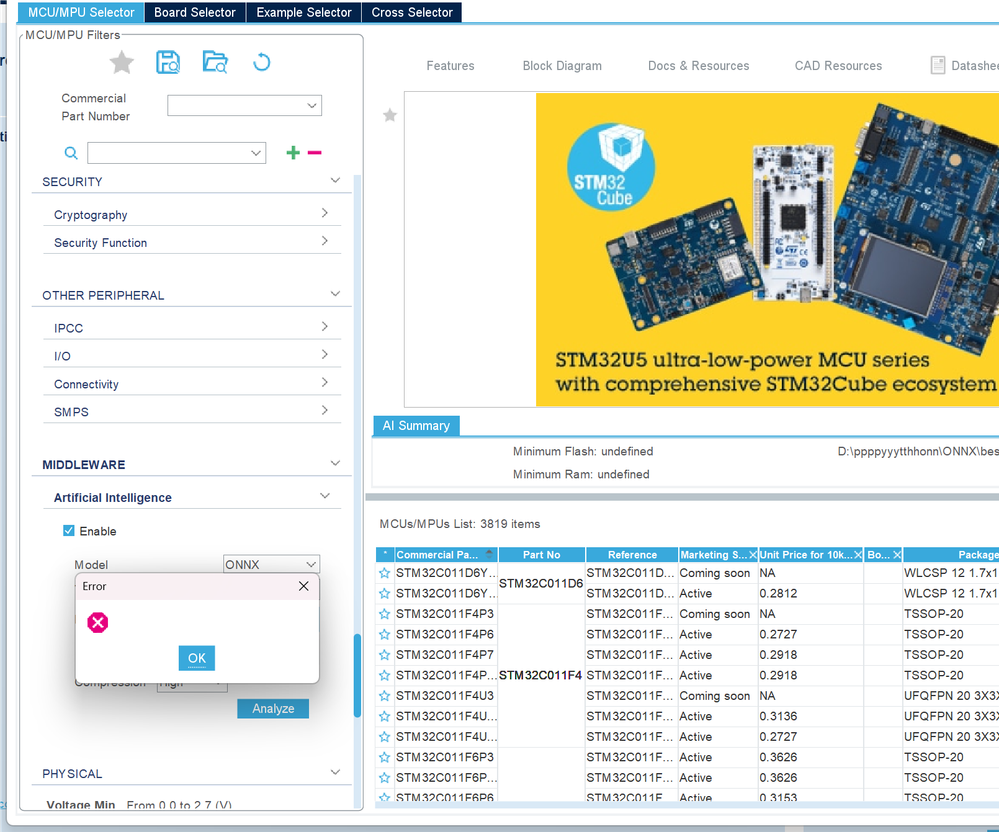

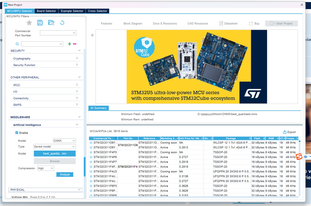

hi,my question is why i can't analyze my model about onnx and cubemx don't back type about my error.my model about onnx size is nearly 3mb,so the compression which i used is high.but the cubemx still can't analyze.emmm i hope their have a handsome guys can help me.i will very appreciate to you!

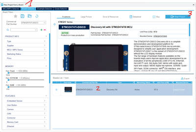

Hello @困困de宇,
I had never seen that you can select AI in this menu, but you should not use it here.
I don't know if you have a board with you, if you don't, I suggest using a STM32H747-DISCO (because we use this one for most of our AI demo).
Here is how to do it properly:
Then say yes when asked to initialize peripherals in default mode.

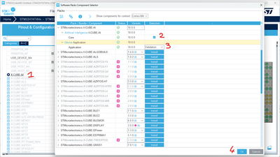

Then activate X Cube AI:
(you may have to install it first)

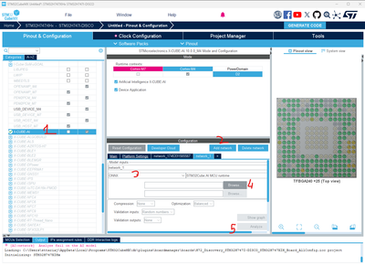

Then browse for your model:
