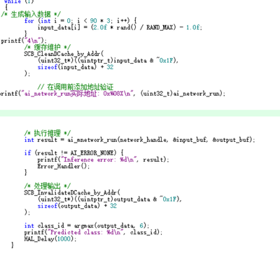

while (1)
/* 生成输入数据 */
for (int i = 0; i < 90 * 3; i++) {
input_data[i] = (2.0f * rand() / RAND_MAX) - 1.0f;
printf("4\n");
/* 缓存维护 */
SCB_CleanDCache_by_Addr(
(uint32_t*)((uintptr_t)input_data & ~0x1F),
sizeof(input_data) + 32
// 在调用前添加地址验证
printf("ai_network_run实际地址: 0x%08X\n", (uint32_t)ai_network_run);
/* 执行推理 */
int result = ai_mnetwork_run(network_handle, &input_buf, &output_buf);
if (result != AI_ERROR_NONE) {
printf("Inference error: %d\n", result);
Error_Handler();
/* 处理输出 */
SCB_InvalidateDCache_by_Addr(
(uint32_t*)((uintptr_t)output_data & ~0x1F),
sizeof(output_data) + 32
int class_id = argmax(output_data, 6);
printf("Predicted class: %d\n", class_id);
HAL_Delay(1000);

This is my main.c file main loop. I call cubeai to generate code file app-cube-ai.c file inside the function. The model initialization was successful, and the model parameters were successfully matched. However, there was a delay in the model inference. The code for Caton is: int result = ai_mnetwork_run(network_handle, &input_buf, &output_buf); . I went inside the model inference function and found that Caton's code was if (inn)
return inn->entry->ai_run(inn->handle, input, output);
else
return 0; Please help me
