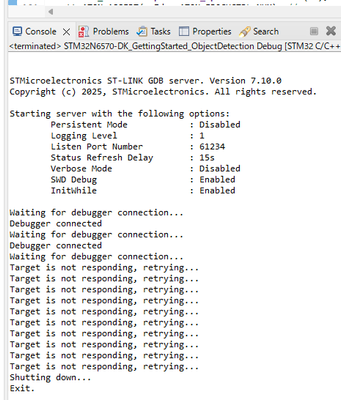

However, the software crashes when I try to execute it.

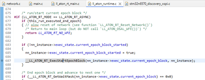

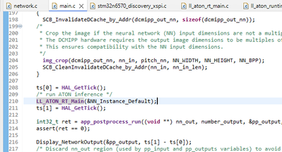

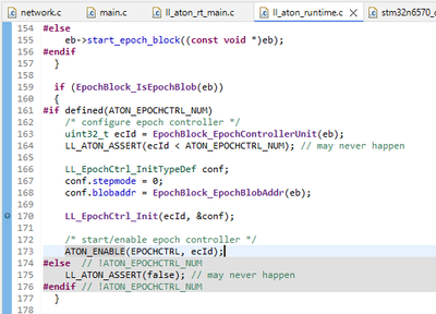

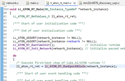

After examining the process, it seems to fail at the following sequence of function calls:
c
LL_ATON_RT_Main(&NN_Instance_Default); LL_ATON_RT_RunEpochBlock(network_instance); __LL_ATON_RT_ExecStartEpochBlock(nn_instance->exec_state.current_epoch_block, nn_instance); ATON_ENABLE(EPOCHCTRL, ecId);
The crash occurs after calling
What could be the potential causes for this problem?

When I performed the final step and ran the process in CubeIDE, the execution crashed.
To investigate the cause, I ran a debug process in CubeIDE and found that it crashed at the specific location mentioned above.
