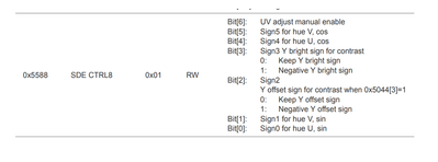

If we look at the drivers function for brightness and saturation, you can see that they both edit the OV5640_SDE_CTRL0 and OV5640_SDE_CTRL8 registers:

Here is the doc of the camera from sparkfun:
OV5640_SetBrightness: write 0x01 / 0x09
OV5640_SetSaturation: write 0x41
The call to OV5640_SetSaturation therefore overwrites bit[3], the sign of the contrast value, to zero.
The correct way to do it should be something like this (it is reformatted, but the important point is the masks):
