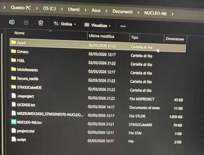

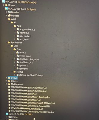

I mean that, when opening the Application or FSBL project inside the folder STM32CubeIDE, there is no Inc folder where Inc files are located as show below:
and when I go to the parent folder of STM32CubeIDE there are the same folders copied!
2026-03-02 11:24 PM
Indeed, STM32CubeIDE does not show include folders, it only shows source folders.
It does not show .h files either. It is the default behavior. STM32CubeIDE does not show exactly the file tree you have in your filesystem (example: Core/Src, and Core/Inc) but only where the sources are.
I will check what could be done in order to show the folders when generated by STM32Cube AI Studio.

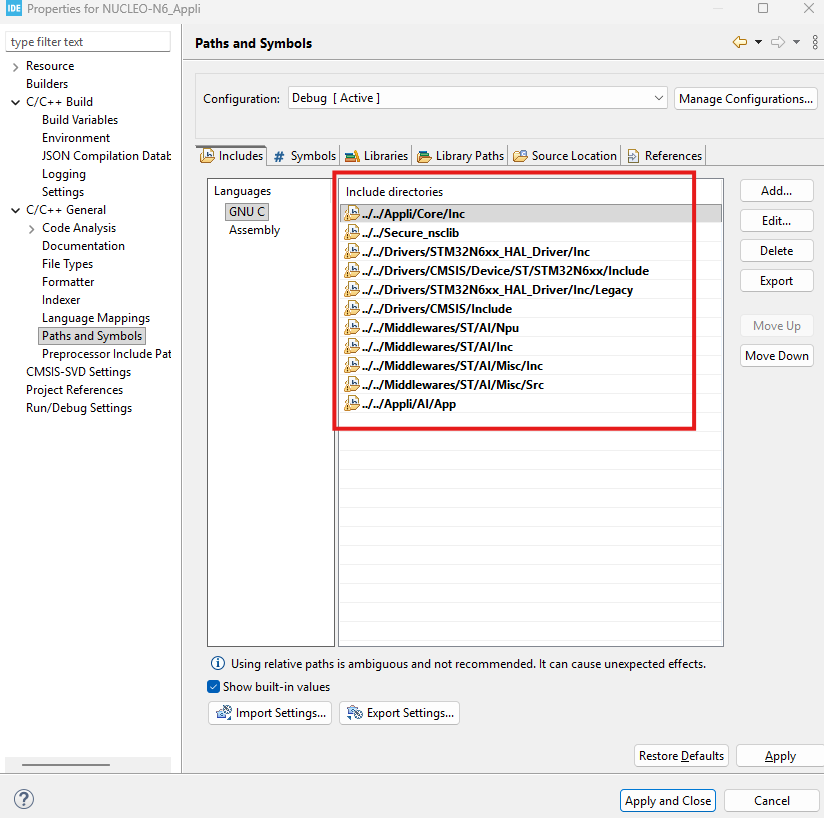

However, you can still check the includes paths by:
- Right-click your Appli project
- C/C++ General > Paths and Symbols
- Includes
Best regards,
Yanis
2026-03-03 12:23 PM - edited 2026-03-03 12:25 PM
Ok, inside the Appli/App/AI folder I’ve placed my NN .c/.h code files and the AI model appearently works using printf.
Appearently, when files are modified inside STM32CubeIDE folder, they are modified also in the copies in the parent folder of STM32CubeIDE.
