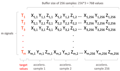

For extrapolation, you need to collect both error values and coefficients to predict, so you will need to collect your data outside of NanoEdge with the following format:
975px-NanoEdgeAI_extrapolation_format
