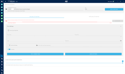

2025-04-03 2:04 AM
Hello @Haze,
Concerning the slider, it was moved to the settings.
You can access the setting page by clicking the first icon on the bottom left corner.
The slider is at the bottom of the setting page:
For the error itself, we are digging further as it does not seem to be the disk space.
I will let you know when I know more.
Sorry for the inconvenience,
Have a good day,
Julian
2025-04-03 2:21 AM
Thanks for the reply, Julian
Dropping the number of threads with the slider seems to have fixed the issue for my system. Looks like NEAI was indeed trying to use all available threads and was crashing the benchmark. I didn't notice the slider had moved and assumed it was using some automatically decided number. It would probably help if there was the slider or a notification for thread selection on page 1 of setting up a project.
Congrats to the team on the new patch, benchmark statistics like the search space are pretty handy when deciding our own preprocessing steps.
Cheers
Haze
