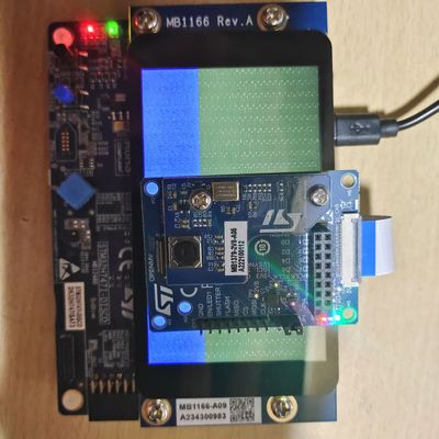

Is my camera module working fine (all 3 LEDs light up)? I am working with the model zoo image classification project, and facing issue.I have

Hello @Hoodand ,
Can you unplug/plug your camera again to see if it helps?
If not, look at the accepted answer in this thread: Solved: STM Model Zoo - STMicroelectronics Community:
You will see in the second attachment of the post author that he had a similar issue
If it doesn't work, it probably means that a part of the setup does not work like him. Do you have another DISCO board and Camera?
Have a good day,
Julian

I don't know how fragile these boards are, but mine died recently too...
In any case, if even with the elf it doesn't work, it probably means that it comes from the hardware sadly
