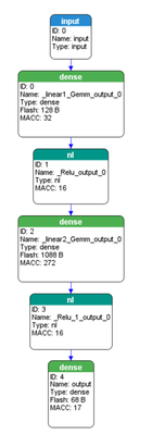

I've got a simple model like this in ONNX:
I set HCLK@216MHz and ran "Inference on target" using Nucleo-f767zi board with X-Cube-AI 8.1.0
I got these useful information:

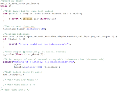

However, when I generated the code, edited the code like

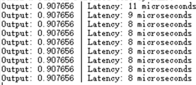

I built the project using X-Cube IDE 1.13.2. I got this:
duration: 8us / sample (prescaler set to 216)
Why is it significantly faster than that from the default "validate on target" button?

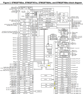

You have to set the prescaler to 108 Mhz to get 1MHz (not 216 Mhz). Keep HCLK to 216 Mhz.
Indeed Timer14 is plugged on the output « APB1 timer clock »  that produces 108Mhz,
as you can see in STM32CubeMX > clock configuration,  whereas « APB2 timer clock » produces 216Mhz.
That explains why you have inference time divided by 2: 8us instead of 17us.
I did exactly the same test you did using TIM14, and I've got the same value using "validate on target" and generating code, with prescaler = 108 Mhz.
You can see in the block diagram of the STM32F767 below that TIM14 is connected to APB1
