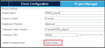

The STM32CubeMX version 6.15 introduces support for ST Arm Clang. More specifically, STM32CubeMX generates projects for the hybrid flavor of the ST Arm Clang toolchain. This will allow STM32 developers to quickly try their existing GCC projects with ST Arm Clang toolchain without having to write a new linker script or consider incompatibilities between Newlib and Picolibc.
Selecting the combination of CMake and ST Arm Clang will create a project targeting the hybrid toolchain:

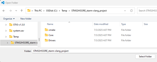

Inside STM32Cube for Visual Studio Code, open the folder containing the project generated with STM32CubeMX.
Select the folder where STM32CubeMX generated the project.

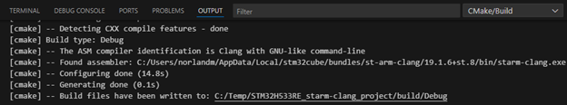

When the installation of ST Arm Clang is complete, CMake is invoked to run the configure step on the project.

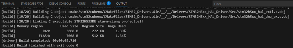

The new ST Arm Clang toolchain as can be seen in the CMake/Build output channel.

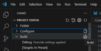

Click the build button to build your project.
The result is shown in the output console. A build analyzer is available to give further insights into the build result. Right-click on any map-file and select Open memories analysis.

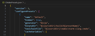

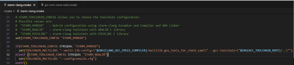

The CMakePresets.json is using the file starm-clang.cmake as the CMake toolchain file.
This line would point to gcc-arm-none-eabi.cmake if STM32CubeMX was generating this file targeting GCC. STM32CubeMX 6.15 and later versions will generate both gcc-arm-none-eabi.cmake and starm-clang.cmake in parallel to allow developers to switch toolchains from inside the IDE. STM32CubeMX will generate these two files only once and never modify them again.
The accompanying starm-clang.cmake will allow developers to select which C library combination to choose.
By default, the hybrid version of the ST Arm Clang toolchains is selected since it has the closest compatibility vs the existing GNU tools for STM32. We recommend developers to try building and testing their code with this toolchain. This transitional step will help them become more familiar with this version before using the full LLVM flavor relying on either Newlib or Picolib by switching the value of the variable STARM_TOOLCHAIN_CONFIG as seen above.

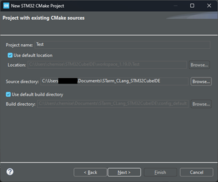

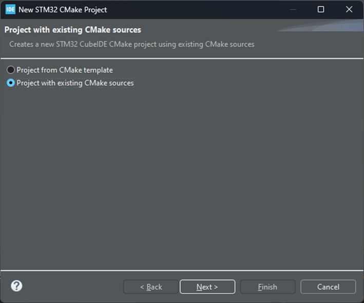

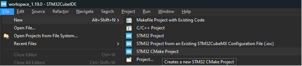

In STM32CubeIDE, go to File > New > STM32 CMake Project
Since the project has been generated with STM32CubeMX, select “Project with existing CMake sources”.
Name the project and select the folder containing the project generated with the STM32CubeMX.

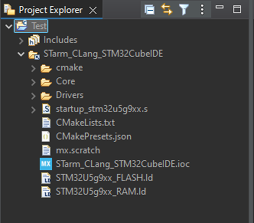

The project will be imported into the current workspace.
You can now start building your project. The compiler will be detected automatically.
