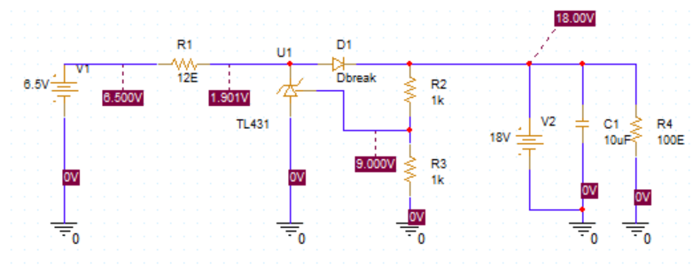

Hii... I'm using TL1431AIYDT to get 5V reference supply ( (+/-)20mV tolerance). My input voltage is 6V. We need to protect the IC from Short To Battery (7V to 18V) (at the output). We are planning to use a schottky to protect from STB. During STB (18V), the VREF pin rises to 9V (50% due to voltage divider). What's the maximum voltage that can be given to VREF pin of TL1431AIYDT ??? Attaching the simulation pic for your reference.

This voltage reference part is very critical in our design. Quick replies are appreciated.. Thanks in advance... :)
