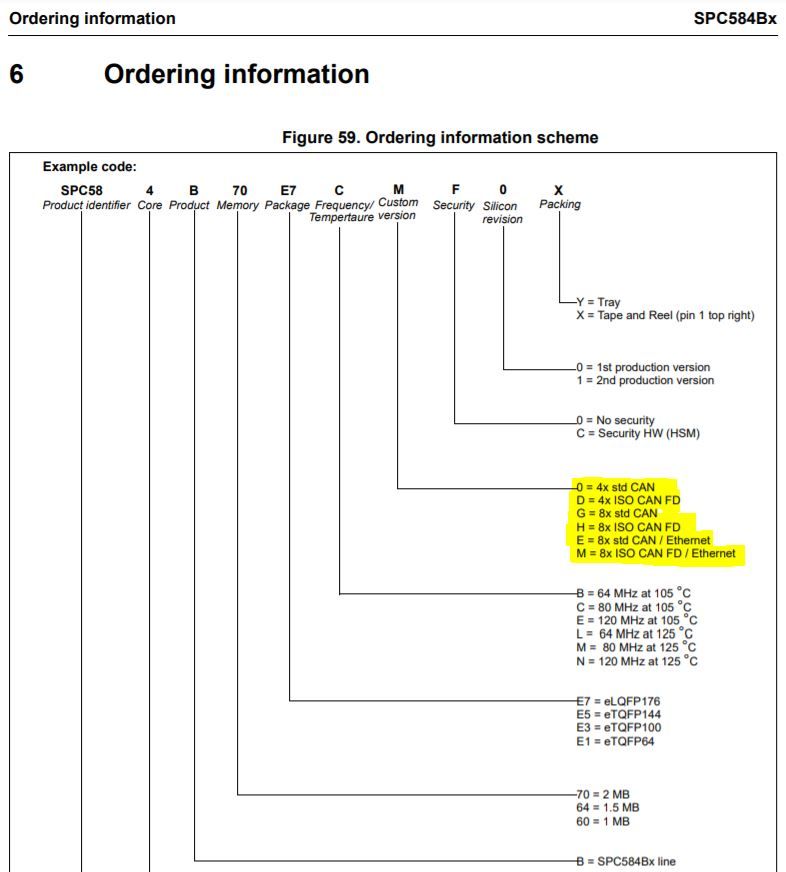

I am planning to use SPC584B70 MCU.
During the review, I have a question in the datasheet.
In the custom version(6. Ordering information):
0 = 4x std CAN
D = 4x ISO CAN FD
G = 8x std CAN
H = 8x ISO CAN FD
E = 8x std CAN / Ethernet
M = 8x ISO CAN FD / Ethernet
If I choose D version, can't I use 'standard frame CAN'?
Can 'extended frame CAN' be used?
Likewise if I choose version 0, can I only use ISO CAN FD?
Please help me.
Thanks.

https://www.st.com/en/automotive-microcontrollers/spc584b70e3.html
In page 128, you will see following image :
I need to select ordering information to order the spc584b70 mcu.
Among them, I am curious about the information about Custom Version (std CAN, ISO CAN FD, etc.).
CPU marked std CAN supports only standard/extended CAN (CAN 2.0A, 2.0B),
CPU marked ISO CAN FD supports standard/extended CAN(CAN 2.0A, 2.0B) + ISO CAN FD?
or ISO CAN FD Only?
I am very much looking forward to your help.
Thank you!
