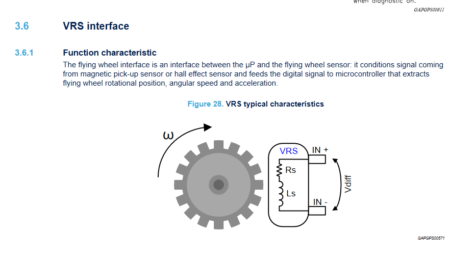

Not sure this is the right section...but I would like to know if it is possible to use the L9177A with an hall effect sensor, in that case, I guess the signal is to be routed to the VRIN+ input, what about the VRIN- input?
Must be connected to GND or to a some threshold voltage? whats the level of the signal the L9177A will recognize with hall sensor signal?

According to the RM , there is a VRS interface (cf screenshot)
Maybe , you can use it.

thank you for your reply, I have read the datasheet before to write, as in the datasheet it is stated the VRS circuitry could work with hall effect sensor, I tested connecting the hall signal (0 to 3.3V square wave) to the VRIN+ and connecting the VRIN- signal to GND without succcess, this is why I asked for help.
